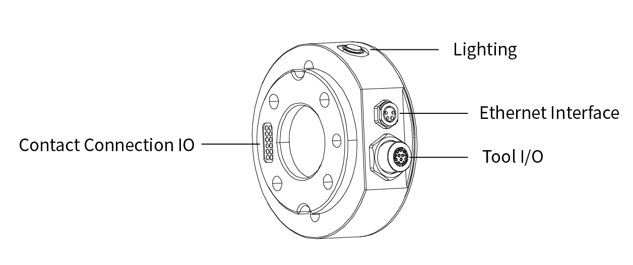

4. Robotic Electrical Interface
4.1 End Flange
The End-effector flange has 6 M6 threaded holes and one Ф6 positioning hole, where the end-effector of two different sizes can be mounted. If the effector does not have a positioning hole, the orientation of the end-effector must be documented in a file format, to avoid errors and unexpected results when re-installing the end-effector.
The end-effector flange referenced ISO 9409-1-50-4-M6 standard.
Mechanical dimensions of end-effector flange (unit: mm)
4.2 Tool IO
At the tool side of the robotic arm, there is an avionic socket 12-pin female industrial connector. This connector provides power and control signals for the grippers and sensors used on a particular robotic arm tool. Please refer to the figure below:
There are 12 pins inside the cable with different colors, each color represents different functions, please refer to the following table:

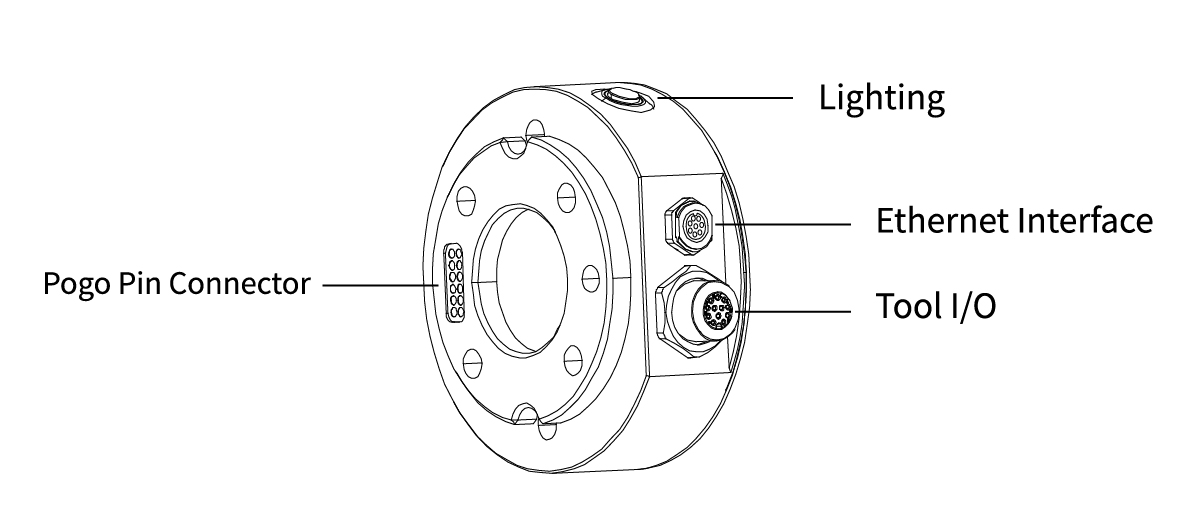

4.3 Pogo Pin Connector
Electrical specifications comply with Tool IO specifications.
4.4 Lighting
We provide a button and LED at tool end, press it and it will be Blue.
The function of this button has not been defined yet, user can custom and develop it. Tool Digital IO: TI2, TO2.

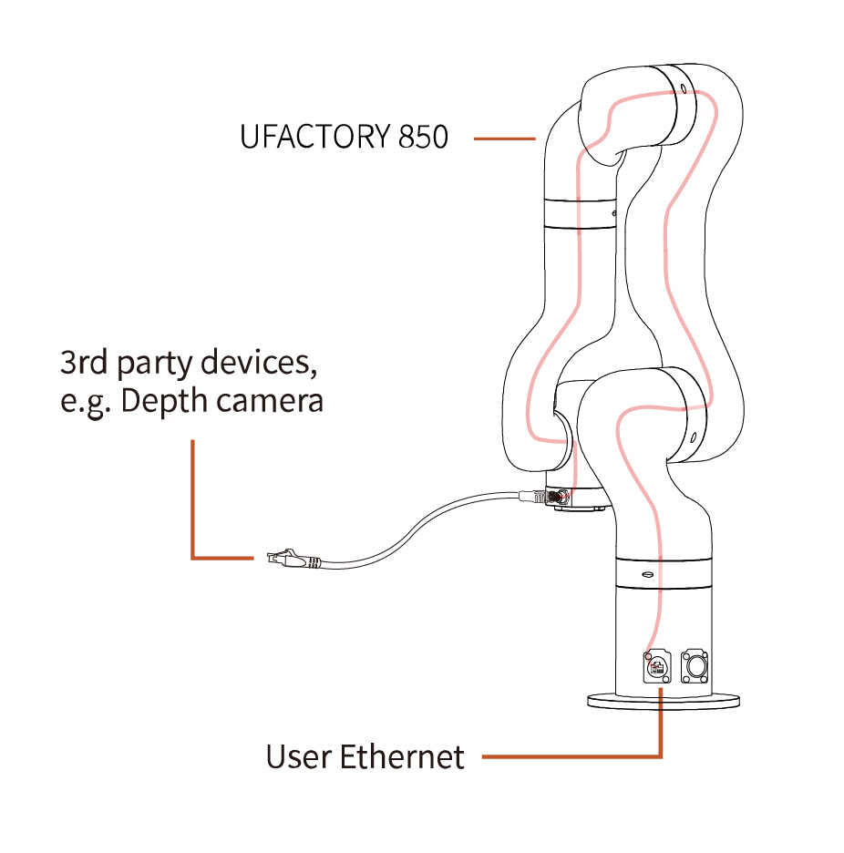

arm.get_tgpio_digital(ionum=2)4.5 Ethernet Interface
The user Ethernet interface(RJ45) of the arm base is connected to the Ethernet interface(M8 4-pole) of the end flange through a physical internal 1000M Ethernet cable, which further enhances the stability of the system. Standard CAT5E Ethernet cable, compatible with most third-party vision devices. You can experiment with using it as a physical signal wire if you want.

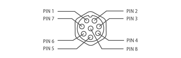

Definition of Industrial Connector
| 8-Pin Connector | |||
| Pin Sequence | Signal | Pin Sequence | Signal |
| 1 | MX2-/DC- | 5 | MX1+/DB+ |
| 2 | MX3+/DD+ | 6 | MX0+/DA+ |
| 3 | MX3-/DD- | 7 | MX2+/DC+ |
| 4 | MX0-/DA- | 8 | MX1-/DB- |
