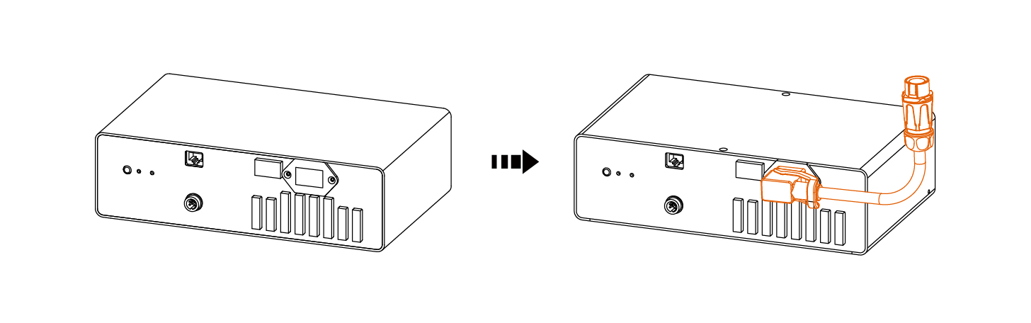

There is a standard IEC plug at the end of the control box’s main cable.
Connect a local dedicated main outlet or cable to the IEC plug. The control box is powered by 100V-240V AC (the input frequency is 47-63HZ) and its internal switching power supply converts 100V-240V AC into 12V, 48V DC, which supplies power to the load of the control box and the robotic arm.
Therefore, it is necessary to check whether the connection between the robotic arm and the control box is secured before use. The hardware protection and software protection of the control box can ensure the safety of use largely. The emergency stop button of the control box allows the user to cut off the power of the robotic arm in the shortest time possible and protect the safety of both personnel and the equipment.
To power on the robotic arm, the control box must be connected to the power supply. In this process, the corresponding IEC C13 wire must be used.
Connect to the standard IEC C14 plug of the Control Box to complete the process, see the figure below.

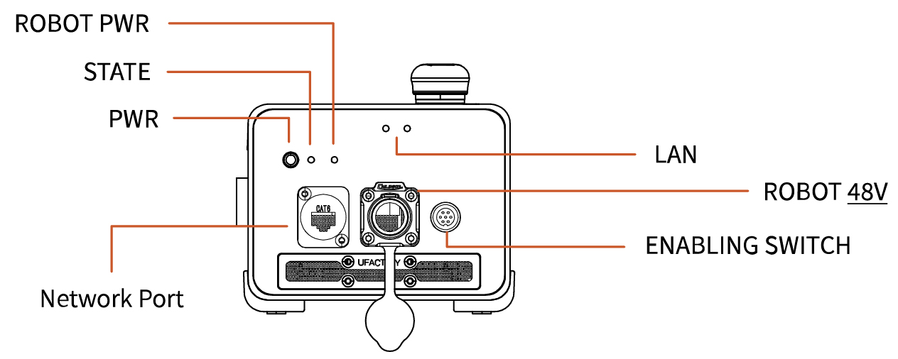

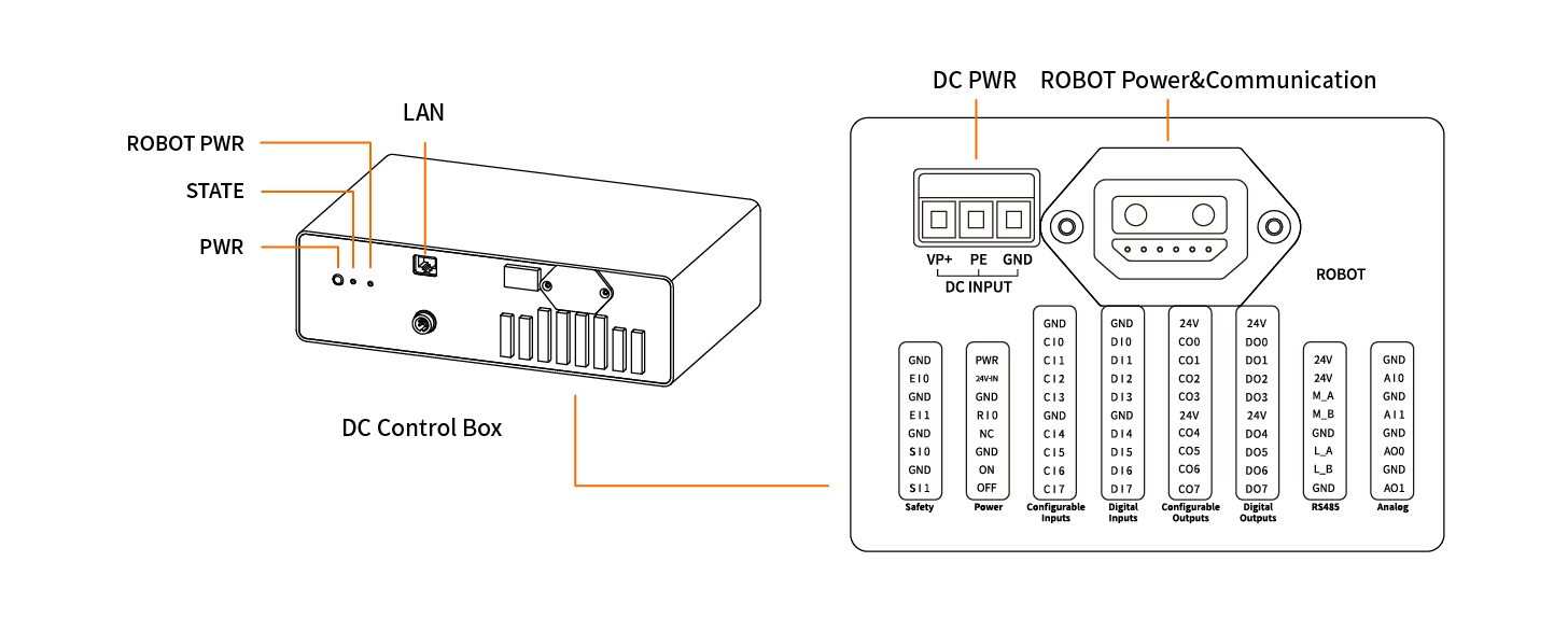

3.3.1 Hardware Connector
ROBOT PWR: The power of robotic arm, it will be RED after enabling the robotic arm.
STATE: The state of controller, it will be GREEN after powering on the controller.
PWR: For internal debug only.
LAN: Left light flashing, right light on.
Connection It will come with a Robot Pwr&Communication Adapter Cable, please connect as below.
3.3.2 Power Supply
| DC8500 Input Power | |
| VP+ | 48-72V |
| PE | Connect to the controller housing(Leakage Protection), not a must |
| GND | GND |
| Output | 48VDC 960Wmax |

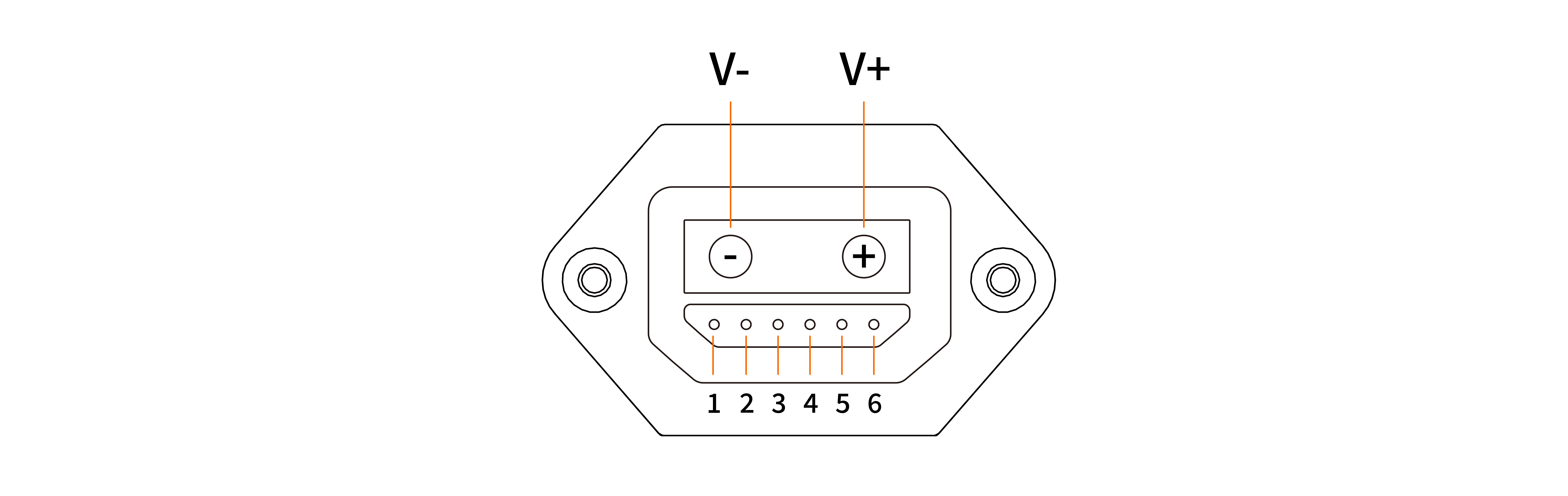

3.3.3 Definition of Industrial Connector
Robot Power and Signal Cable:
| PIN | Functional Definition | PIN | Functional Definition |
| V+ | 48V | V- | GND |
| PIN1 | RS485-A, Arm | PIN2 | RS485-B, Arm |
| PIN3 | PE | PIN4 | PE |
| PIN5 | RS485-A, Tool | PIN6 | RS485-B, Tool |

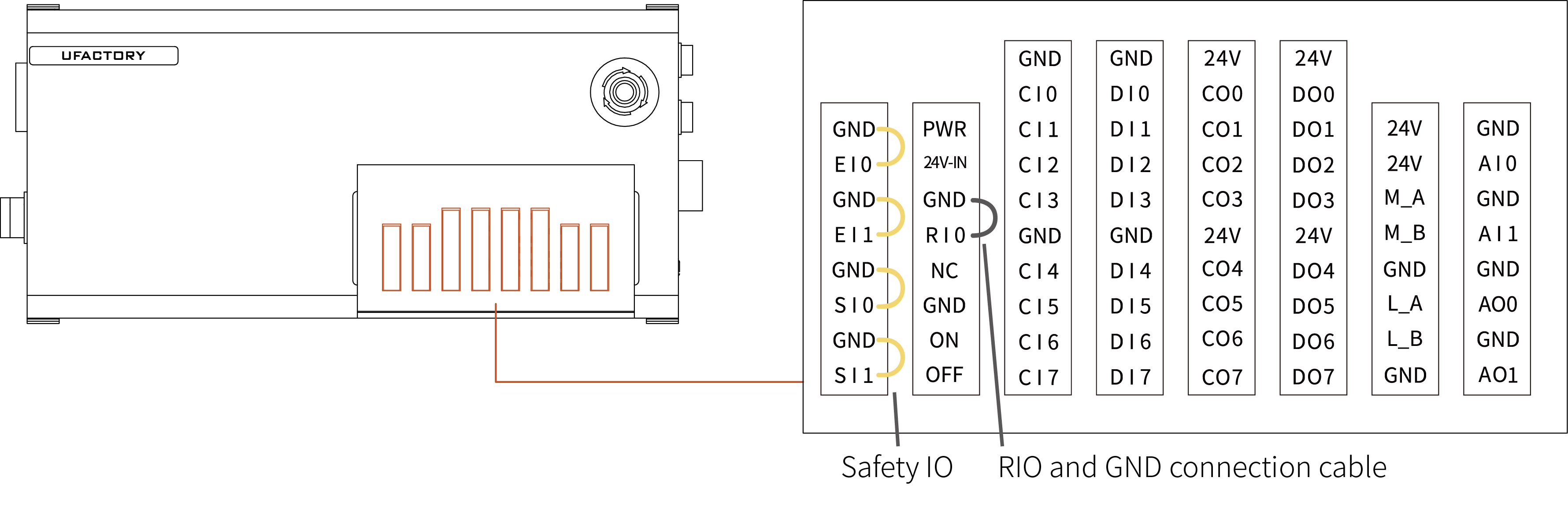

The figure below shows the electrical interface layout inside the control box.

3.4.1 Safety IO(EISI)
All safety I/Os exist in pairs (redundancy) and must be kept in two separate branches. A single I/O failure should not result in the loss of safety features. There are two fixed safety inputs:

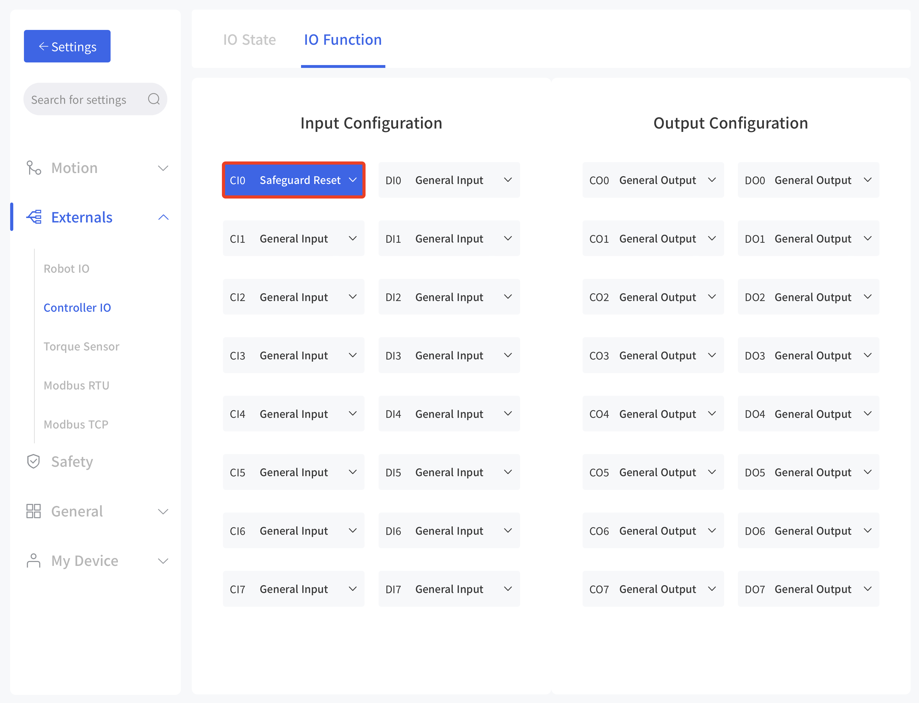

How to realize the protection reset function with reset button:
- Configure "CI0" as the safeguard reset in UFactory studio. The specific steps are as follows: Enter 'Settings - External - Controller IO - IO Function', set CI0 as safeguard reset and save.
- If 850 needs to resume motion, connect SI0 and SI1 to GND, and trigger the motion of 850 by connecting CI0 to GND; if 850 needs to pause the motion, disconnect SI0 and SI1 from GND.
NOTE DI0-DI7 are not equipped with the following three functions: stop moving, safeguard reset, and reduced mode.

- Press the emergency stop button and turn off the power of the control box.
- Connect RI0 to GND with a cable.
- Turn on the power of the robot. After hearing the sound of 'beep', it means that the IP address of the robot has been reset successfully. The reset IP is 192.168.1.111.
- Please unplug the cable connecting RI0 and GND and wait for the robot to start up (60 seconds).
- Enter 192.168.1.111:18333 in the browser to connect the robot.
